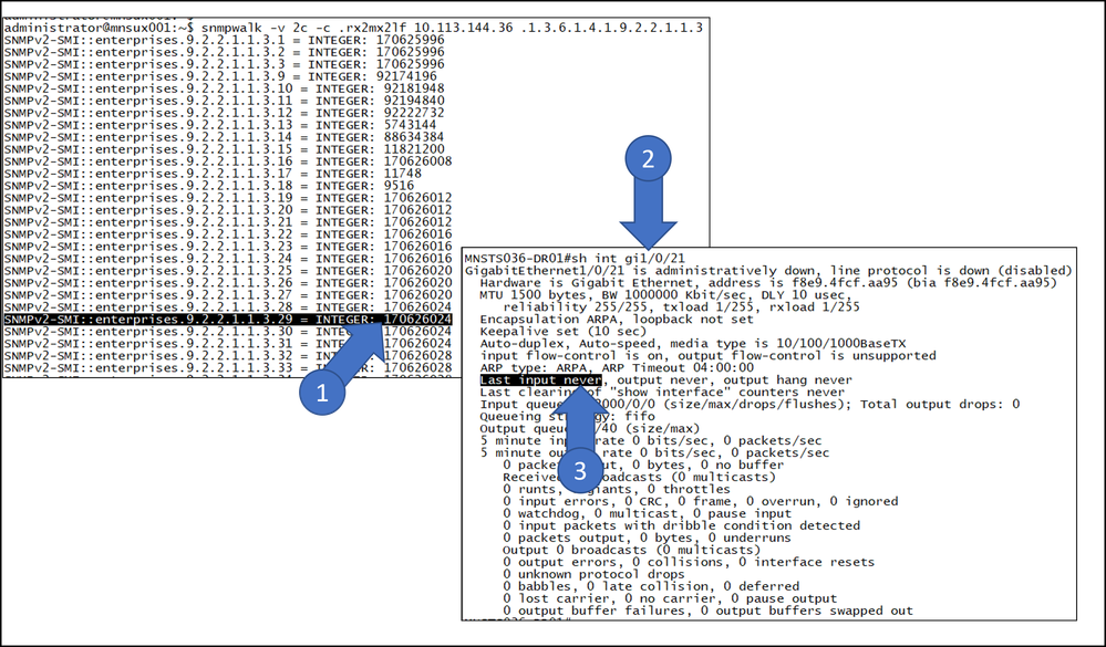

I'm trying to get the Last input never information via snmp regarding to each interface from my Cisco C9200L-48P-4G switches? The idea is create a discovery rule in the Zabbix to monitor the amount time that each interface in the switch is in use or not and by how long time, this is the main idea here.
To do that I need to know which the correct OID that I may to use?

Just to comment I saw another post here in the community saying for:
ref.: https://community.cisco.com/t5/network-management/cisco-oid-for-getting-info-on-last-input-and-output-interface/td-p/428842
1. Elapsed time in milliseconds since last line protocol input packet was received: I can use this OID .1.3.6.1.4.1.9.2.2.1.1.3
2. Elapsed time in milliseconds since last line protocol output packet was transmitted: I can use this another one OID .1.3.6.1.4.1.9.2.2.1.1.4
The result is positive and worked partially fine. But I don't know the reason for the interface that never was used return some time, as you can see the evidence in attached picture. If I go to check via command line, shows like LAST INPUT NEVER.2022-11-08 10_51_42-MNSUX001 - SecureCRT.png

Hi @balaji.bandi ,
Thank you for your answer. See...
As I noticed before can get by SNMP the correct information related to the LAST INPUT informations of interfaces in use or not as you can see below.
The main problem is that when one Interface that never was connected (see in the arrow "2" , below), for example, via command line shows the correct information as Last input never(See in the arrow "3", below). But when I perform the Snmpwalk to get the OID content information from the device, it return a value as you can see in the arrow "1" resulting in a wrong return to the Zabbix monitoring tool.
In resume, what I need to know from some cisco specialist is when the network device pass to consider the result Last Input Never???
On Cat 9200 and  what IOS XE Code running ?

I did not find nothing until at the moment. Same the Data sheet of this equipment continue making references to this MIB "OLD-CISCO-INTERFACES-MIB" that is the same that I'm using.
But I end up of see a stranger thing here... The returned time for these interfaces never used is exactly the same present in the uptime of the device. So maybe this is the way that the device check when one interface never used just comparing these two informations, if they are similar so it never was used.
I think! What do you think?

That's it folks,
I found the logic for never use interfaces. They just compare the Uptime with the Last Input Never information that we get via snmp. If both are the same, so means that there interface in the switcher never was used.
Now that I got the logic for this question so this topic was solved.
