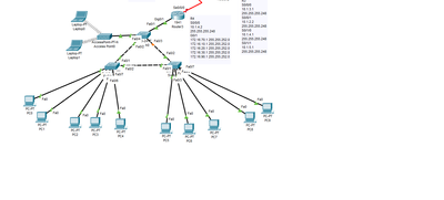

PC in vlan unable to ping router
Teoyucheng
I have done the subinterfaces encapsulation on the router, done the switchport access vlan, switchport mode access
but i am not too sure where to put the switchport mode trunk and i am still unable to ping the router any help is appreciated
the problem was that Vlan 10 did not exist on the switch connected to the router. I manually created the Vlan. All links between the switches and the router must be trunks. Working file attached.
15 Replies 15
Richard Burts
Your drawing shows information for r3 and r4. But shows only a single router. Is that significant?
If I interpret the drawing correctly the interface trunk should be FA0/1.
HTH
Rick
Im sorry but the R4 labeling is wrong it is supposed to be R3
balaji.bandi
You need to configure the Trunk port connected to the router.  (in your case as per the diagram fa 0/1)
still not working post the switch and router config ?
BB
It has already been trunked to Fa0/1

Which PC (which IP address) cannot ping which IP address on the router ? You have put an IP address on the physical interface of the router, which means that this is the Vlan 1 IP address. Typically, your switches have an IP address in Vlan 1 as well.I have added the management IP addresses to the Vlan 1 interfaces of the three switches (see project file attached).
PC0 172.16.10.2  should be able to ping the 172.16.10.1 on the r4. I am still unable to ping with the file u sent
It sounds like @Georg Pauwen has got it. If problems persist please post the output of these commands on the switch
show vlan
show interface trunk
show interface status
HTH
Rick
The only issue right now is that PC0 and PC1 are in vlan 10 PC2,3,4 are in vlan 20 and when i switchport access vlan 20 the vlan 10 stops working
Edit/ Create vlan 10 and 20 on switch connected to router
It works now but can i ask whats the command to manually make the vlan?
Edit/ vlan (number)
