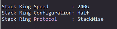

Hi Experts,
Above is the output of stack-ports summary. All switches are working fine all ports are up from the 3 switches. The only issue here is that it is not working as a "full ring" as there is no stack cable connected to switch 1 and switch 3.
I just wanted to add as well, all of the IOS version is the same for the 3 switches as all of the 3 switches are in functional working as a stacked switch. Again the only issue is this is not working as a full ring stack because of the missing cable on switch 1 and switch 3.
Current cables are ok; left port of from sw 1 to right port on sw 2, and sw 2 left port to sw 3 right port. just make sure  sw 1 is master with priority set to 15; not master due to other factors (boot speed, MAC value) ;  I think command should be show switch detail   if not, change switch priority.
this output should be like this
SWT0001#sh sw det
Switch/Stack Mac Address : 7xxxxxxxx80 - Local Mac Address
Mac persistency wait time: Indefinite
H/W Current
Switch# Role Mac Address Priority Version State
*1 Active 7018.xxxx.4c80 15 V07 Ready
2 Member 7018.xxxx.1600 1 V07 Ready
3 Member d4ad.xxxx.ef80 1 V07 Ready
4 Standby 7018.xxx.1100 1 V07 Ready
5 Member d4ad.xxxxe000 1 V07 Ready
Stack Port Status Neighbors
Switch# Port 1 Port 2 Port 1 Port 2
1 OK OK 2 5
2 OK OK 3 1
3 OK OK 4 2
4 OK OK 5 3
5 OK OK 1 4
U can do this after hours but we had done it during normal hours without any problems;  in worst case, stack will reboot, which may take upto 5 minutes for ports to be active again.
No need for any fancy graphs or MNS software .
Regards, ML
**Please Rate All Helpful Responses **
