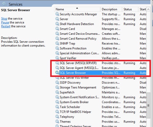

12-17-2015 08:06 AM
Please follow the below link
http://www.cisco.com/c/dam/en/us/td/docs/telepresence/infrastructure/tmspe/install_guide/Cisco-TMSPE-with-Cisco-Unified-CM-Deployment-Guide-1-4.pdf
Here you need to make sure the prerequisites are fulfilled, you need to enable the below services.
TCP/IP or Named Pipes protocol must be enabled.
TCP/IP is the preferred protocol, see below.
SQL Server Browser must be running and able to listen to UDP port 1434.
I have attached the screenshot for your reference.
Regards,
Raaj
