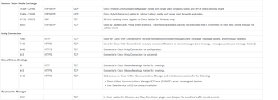

What's the port range for UDP & TCP?
So both local and VPN login fails ?
Ports and Protocols
The client uses the ports and protocols listed in the following table. If you plan to deploy a firewall between the client and a server, configure the firewall to allow these ports and protocols.
For jabber port always  refer the Jabber planning guide. But  make sure you refer the guide for the jabber versions you use. The below one is for versions 14.
https://www.cisco.com/c/en/us/td/docs/voice_ip_comm/jabber/14_0/cjab_b_planning-guide-cisco-jabber-14_0/cjab_b_planning-guide-cisco-jabber-129_chapter_01010.html?bookSearch=true
