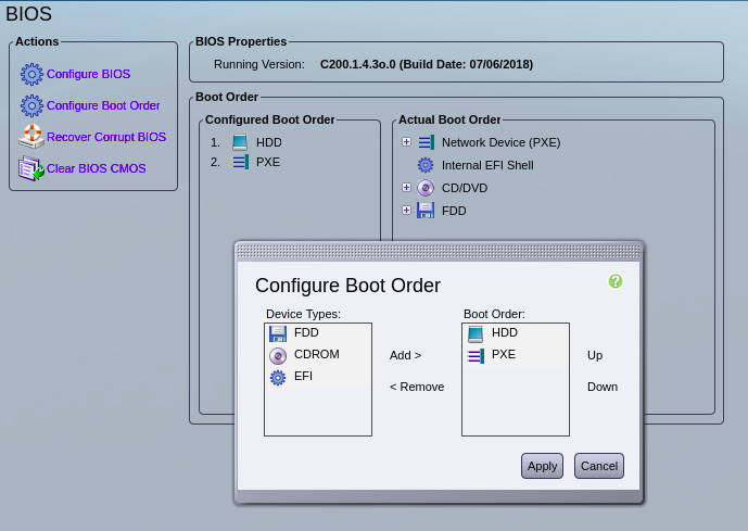

How do I do that?  I don't see any option to reference the mezzanine slot when I configure the boot order.
For that matter, I don't see any option to create a boot order entry, only options to set the boot order, i.e:
Screenshot from 2020-02-16 11-15-57.pngScreenshot from 2020-02-16 11-16-20.png

If you can't get it to boot with the local generic 'HDD' item as you have it shown, then you may need to check in the F2 setup to see if there is a way to change boot order
