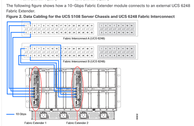

I may be way off, but seems like you have a UCS 5108 chassis with servers, but no UCS Fabric Interconnects and maybe no IOMs.
What does the back of your chassis look like?
Can you send a picture of the back?
What is in "Fabric Extender 1" and "Fabric Extender 2" module slot?
If you could unseat whatever module is there and provide the Serial Number to 100% confirm what hardware you have.
"Fabric Extender 1" and "Fabric Extender 2" reference Figure 6 of the 5108 Chassis spec sheet:
https://www.cisco.com/c/dam/en/us/products/collateral/servers-unified-computing/ucs-b-series-blade-servers/spec_sheet_c17-644224.pdf
Sure, here is the backplate
Steven Tardy
That picture shows UCS-2204XP which are I/O Modules (IOM) (which are FEXs (Fabric Extenders)) which to my knowledge are practically unusable WITHOUT a UCS Fabric Interconnect (FI). Like a UCS 6248 FI.
Yeah. The server may technically power on, but would be nearly unusable.
