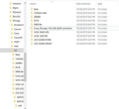

I am attempted a bare metal install of Windows Server 2016 onto a UCS S3260 storage server. I've already updated to the latest firmware. I have created virtual disk volumes on the installed physical disks. When I attach the Microsoft Windows server ISO and boot, the Microsoft Windows SETUP begins and does not contain an out-of-box driver for either of the RAID controllers. So Windows SETUP cannot detect a target volume onto which to install. I understand that at this point I need to mount a different ISO containing downloaded drivers from Cisco and ask Windows SETUP to scan for matching device drivers. I've downloaded  sets of UCS driver ISOs from Cisco 3.1(3b) and 4.0(4d) which look like the should contain a matching driver, but Windows SETUP does not find a match and cannot continue. Screenshots attached below.

The drivers I need are for both the internal controllers - the LSI controller for the SATA drives (boot SSDs dedicated to the server) and the UCSC-C3X60-RAID (aka MegaRAID) controller for the 56 slot disk array containing the data drives.
The screenshot shows that Windows SETUP recognizes the hardware thumbprint but when browsing the downloaded media from Cisco, can't find a matching signed driver.
