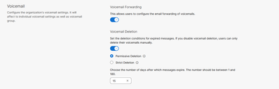

John Steele
Should see this in Services-->Calling-->Service Settings-->Voicemail Deletion
