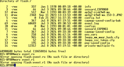

Regarding the 2702i Interface resets, I cannot find Your mentioned event.r0 and event.r1 files on flash.
Here ist the Directory-Info from a 2702i-Flash:
