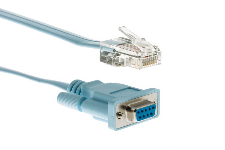

no i don't have original cable
i use this one
and did use this converter too with normal RJ45 cable
without any result but i did use both of them on another device and worked perfectly
i have serial port on my PC
Hmm, ok the blue cable should work (if it's the Cisco one, there sadly is no real standard in regards to serial ports...). I suggest to try another PC, or an USB-Serial adapter for testing.
