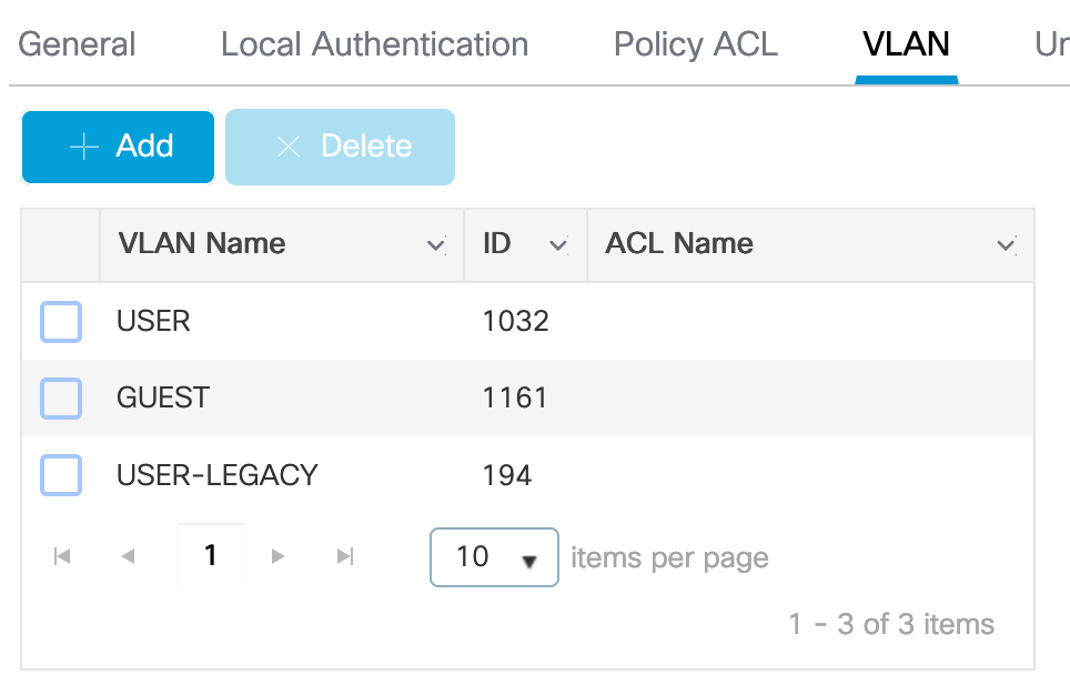

A typical problem for this is that the VLAN was not added to the AP on the Flex-Profile:
Also check that the VLAN is added to the trunk where the AP connects.

I added the vlan to the flex profile and it was working. Thanks!
