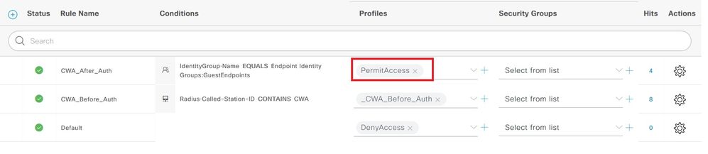

OK, two things need to be checked:
After the client accept the AUP page/portal, ISE is sending back to the WLC two things to apply them to the client session (yes, you will see successful log from ISE and the WLC moved the client to run state with below):
1. ACL: DENY_GUEST_INTERNAL
2. security-group-tag=0006
ISE shouldn't send group tag in this case
For the ACL, best practice is to not use ACL to control guest traffic, instead use Anchor deployment in the DMZ or VRFs design so you can isolate the guest traffic from corp traffic. In this case it might causing the problem somehow, you can start removing the security tag first from ISE config then if that doesn't fix the problem then try to remove the ACL too from ISE reply and make it simple "Permit Access" as in below screenshot.
I'm positive one of the above is causing the issue you have.
[cid:image001.jpg@01D78B1D.3D3E8960]

Good morning Grendizer,
First, thank you for your continued help. I really appreciate you taking the time to help me try and solve this issue.
Secondly, it was the ACL. We're going to look into the best practices for deploying the VRF's design, but as soon as I removed the ACL... it worked.
Thank you!
