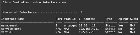

I have an alternative solution that doesn't require downgrading of VMware Workstation / Fusion.
When I deployed vWLC with AireOS 8.10.151.0 directly in VMware Fusion, I experienced the same behavior of vWLC Management interface - I could't even ping IP address of my MacBook and could only access vWLC via Service-Port.
Since vWLC is not supported on Type-2 hosted hypervisors, workaround is to deploy ESXi in VMware Fusion / Workstation and deploy vWLC within the ESXi hypervisor. Once I did that, Management interface is working as expected.
IP@ on my laptop is 10.10.4.10. I am now successfully pinging it from vWLC and vWLC is reachable via CLI/GUI on its Management int (none of this was working when vWLC was deployed directly in Fusion).
