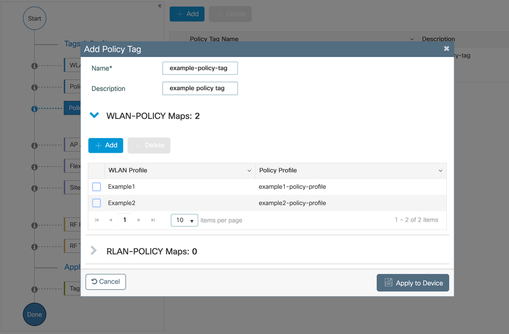

I have a Catalyst 9200L and three Catalyst 9115 access points with EWC. I iam trying to understand SSID to Vlan setup when the vlans are routed on the switch and the port connected to the AP is a trunk prot with the management port as native.
I have used 2504 WLC and 1852 APs before with vlan switching handled by the layer3 switch (trunk port on the switch, managment vlan native, additonal vlans tagged>>>connected to port on 2504 with interfaces defined in each vlan, and each wlan set to that particular interface.) That works great. As I understand it, the APs create a capwap tunnel over the management vlan (each ap is connected to an access port on that vlan), then the vlans fron the switch are trunked to the WLC and the WLC handles the routing to the particular interface.
But EWC seems very different. Since there is no controller appliance on this network, and with the same switch configuration essentially (trunk port with routing handled on the layer3 switch), what is the best way to route wlans to vlans? Ii have a test wlan setup with policy and tag both setup and i have wireless access to the managment vlan. Policies only let me add one vlan per AP.
Please help.
34 Replies 34
Rich R
- Does the ewc itself handles Vlan routing between wlans instead of it going back to the switch?
No.  The EWC management (on native VLAN) is purely for your SSH/https management access to the EWC and the AP CAPWAP control connection to the EWC WLC.  No client data is switched by the EWC at all.  It is simply bridged/dumped onto the trunked VLAN on the switchport by the AP.
- Can the vlans on the EWC match the vlans on the switch or will that conflict?
They must match or it won't work - the VLAN you configure for each WLAN is what the client traffic will be tagged with on the switchport
- Will traffic between wlan flex connect Vlan and wired Vlan on the 9200 be on the same broadcast domain essentially?
Yes
- can the 9200 still handle the dhcp, acls, etc instead of the ap?
The AP cannot handle it so the 9200 must handle it.
- how does the traffic actually route from the wireless client back on one Vlan to the switch and then to a wireless client on another Vlan if the 9200 handles the routing? In other words, how does flex connect work differently than the 2504 or a 9800 wlc with standard trunk ports in terms of the traffic.
Flex on 9800/EWC/2504 is all the same.  Central switching tunnels client traffic to the WLC over CAPWAP and the WLC bridges it to VLANs connected to the WLC switch port.  With flexconnect local switching all client traffic is simply bridged directly to the VLAN on the AP port, no different to traffic coming from a hardwired client on that VLAN.
-Now my struggle point is assigning particular VLANs in the flex profile to particular WLANs. What am I missing?
That is done is the "wireless profile policy" using the VLAN(s) you defined in the flex profile.  You can just enter the VLAN number/ID, not necessary to use the name.
-I would not need a flex profile in that case then right?
The Flex profile is used to define the VLANs the AP must use and give them names.  You can then use those VLANs for the WLANs.
So then Rich, for the flexconnect configuration, I need to create a wlan profile for each ssid, then a policy profile for each vlan with that vlan assigned in the policy profile, then a policy tag that maps each wlan profile to each of those policy profiles, then each assigned vlan also added to a single flex profile, right?
Yes but not clear what you mean by "then each assigned vlan also added to a single flex profile, right?":
The VLANs for the SSIDs are defined in the flex profile for the AP - a bit like you define VLANs for a router or switch to use.

That is where all of this gets confusing. I don't have a 9800 in place, only the EWC. Most of the documentation for flex connect assumes there is a remote appliance. The only EWC configuration example (https://www.cisco.com/c/en/us/products/collateral/wireless/embedded-wireless-controller-catalyst-access-points/white-paper-c11-743398.html) is really vague on the flex connect part and does not explain how the flexconnect profile relates to the policy profile. I only understood the need for one policy profile for each vlan based on Scotts picture above. Here are some screenshots of what I meant above:
Screenshot 2023-12-04 at 5.23.19 AM.pngScreenshot 2023-12-04 at 5.25.22 AM.pngScreenshot 2023-12-04 at 5.25.31 AM.pngScreenshot 2023-12-04 at 5.26.53 AM.pngScreenshot 2023-12-04 at 5.27.05 AM.pngScreenshot 2023-12-04 at 5.28.22 AM.pngScreenshot 2023-12-04 at 5.29.58 AM.pngScreenshot 2023-12-04 at 5.30.10 AM.png
Then I would tag the aps with those profiles. Am I missing anything?
      >...Most of the documentation for flex connect assumes there is a remote appliance
                     Since you only do flexconnect the principles remain the same.
                         >...Then I would tag the aps with those profiles. Am I missing anything?
    Not really try it out ; verify  controller configuration afterwards with CLI command show tech wireless ; feed the output into

Yes when reading the general 9800 guides you just have to remember anything applying to central switching (user traffic switched by WLC) is not relevant in the EWC context because it only supports flex local switching which means all the EWC does is configure the AP.
Ro rich, does my configuration look good above? I am really struggling getting this thing working. When I first boot it up, clients connect, but then they just drop out of no where, and eventually, connections try to connect and fail. When they do connect, they are in the proper vlan and they have an IP in the DHCP range for that vlan (switch is handling the DHCP). Just frustrating. I defaulted and am reconfiguring. I will post a config for both the EWC and the 9200 switch when I am finished if it fails again so that you guys can take a look. I have done everything major that the Wireless Config Analyzer says to do.
To be honest I do almost everything on CLI so I haven't looked over your config specifically.  I just find it easier to read a few lines of text instead of trying to decipher screenshots <smile>
Maybe post the "show run" config when you're finished configuring along with "show ap tag summ" and "sh wireless client mac-address <aaaa.bbbb.cccc> detail" for one of the connected clients.
I'm learning CLI slowly but surely. I will send you all those things tonight when I get home. Thanks so much!
Here are the CLI outputs Rich:

wireless tag policy lewis-home-policy-tag
 description "Lewis Home Policy Tag"
 wlan "Lewis Home Guest" policy guest-policy-profule
 wlan "Lewis Home Wireless" policy user-policy-profile

OK one thing to note after reconfiguration, The primary access point seems to work just fine. I’m able to connect to it every time when I’m right beside it. If I walk over to the other access point, so that I connect to it, it spins and spins and spins, and never gets an IP address. Then I walked back to the primary access point, and I connect right away. Maybe that’s a clue.
Can you do a "show ap name Laundry_Room tag detail" and "show ap name Hallway tag detail" just to see all of the tag config on the APs.
At a glance I don't see any obvious issue.

Let me check those. I just rebooted the switch and the access points powered up differently so that the hallway became the active ewc this time. Now devices will connect it just fine and not the other access point. It seems like even though both access points are broadcasting, only the active one works.
Thu Dec 07 2023 20:51:35 GMT-0600 (Central Standard Time)
#show ap name Laundry_Room tag detail
AP Name            : Laundry_Room
AP Mac             : a49b.cd2a.47e4
Tag Type             Tag Name
Policy Tag           lewis-home-policy-tag
RF Tag               lewis-home-rf-tag
Site Tag             default-site-tag
Policy tag mapping
WLAN Profile Name                Policy Name                      VLAN                             Flex Central Switching           IPv4 ACL                         IPv6 ACL
Lewis Home Guest                 guest-policy-profule             NA                               DISABLED                         Not Configured                   Not Configured
Lewis Home Wireless              user-policy-profile              NA                               DISABLED                         Not Configured                   Not Configured
Site tag mapping
Flex Profile         : lewis-home-flex-profile
AP Profile           : lewis-home-ap-profile
Local-site           : No
RF tag mapping
5ghz RF Policy       : Global Config
2.4ghz RF Policy     : Global Config
Thu Dec 07 2023 20:52:24 GMT-0600 (Central Standard Time)
#show ap name Hallway tag detail
AP Name            : Hallway
AP Mac             : a49b.cd2a.59fc
Tag Type             Tag Name
Policy tag mapping
Site tag mapping
Local-site           : No
RF tag mapping
  -  Validate the tag configuration using the following command:  # wireless config validate
