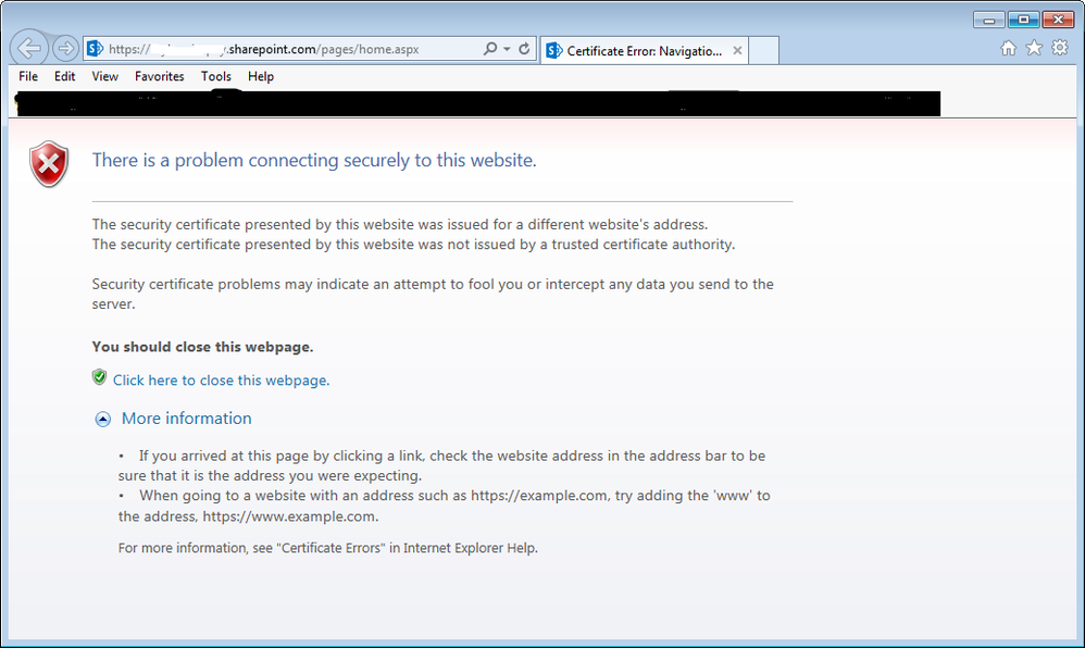

Hi Guys,
It appears that I'm still not out the woods yet. I'm still getting reports from various users of different devices who've told us they can / can't connect using different devices. I found out that those phones I originally mentioned were provided by a third party and these weren't actually tested on our Guest Wi-Fi prior to being distributed to our users. I've put that point back to our management and told them to give me one to test with myself which I'm going to be getting my hands on soon I hope. I've got my own personal WLC setup at home (WLC 2504 and some AP's) to test with too which will be good to see if there's any difference between our Production guest Wi-Fi at work and my own Guest Wi-Fi at home. I also forgot to mention that the WLC at work is a virtual WLC (vWLC) running on some physical host. I don't know if that's relevant?
I'm actually now getting other reports about a slightly different error that I've attached below. Here is some feedback I've had from my users:
Device Type: User's Mobile
Device Name: MS Lumia 640
Operating System: Windows Phone 8.1 Update 2
How many times did the cert error page load: 1
Was the option to continue there: Yes
Device Type: User's Laptop
Device Name: Corporate issue Lenovo ThinkPad T430
Operating System: Windows 7 Enterprise
How many times did the cert error page load: Didn’t – IE sat there trying to load the default home page (Intranet) then failed (pic 1), no option to go to Wifi login page.
Was the option to continue there: Nope
Daft device to try on Guest
Pic 1:
Other users:
Device Type: Personal Mobile
Device Name: Samsung Galaxy S5
Operating System: Android V6.0.1
How many times did the cert error page load: Device default homepage was Google but wouldn’t go to wifi Login screen.
Device Name: Samsung S7 Edge
Operating System: Android V7
Device Type: Personal mobile
Device Name: Apple 6S
Operating System: iOS 11.4
How many times did the cert error page load:1
I am confused as to why some are able to be redirected with the option to continue and some aren't. Can anyone give me some pointers? Anyone seen this before?
