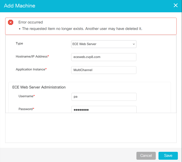

Hello guys,
I am installing now ECE 12.5 for the lab, and when I try to add ECE Web Server to the Inventory of the PCCE SPOG, I've got this error (please see the screenshot in the file attached):
Error occurred
  • The requested item no longer exists. Another user may have deleted it.
I tried to check the CCBU log, but there is no much significant help - only the general java error without details:
REST_API_EXCEPTION: %[exception=java.lang.NullPointerException][message_string=Error executing task RuntimeStatusRulesTask]: The REST API has caught an exception java.lang.NullPointerException
Maybe someone had this or similar issue in the past? Any help is much appreciated.

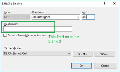

The issue is solved. The problem was not related to the certificates (you don't need to add CA-signed certificate to AW server!!!), but to wrong IIS Binding settings on my ECE Web server. I automatically configured it wrong with the hostname like this:
So I assigned my 443 connection to hostname only. However, SPOG API sends requests to IP addresses like this:
The specified URL does not exist.][message_string=Error 404 occurred while trying to POST to https://10.2.1.40:443 ]
I reconfigured the IIS Binding to have the Host name setting blank (then it supports requests both for FQDN and IP):
Now I can add the ECE Web server to SPOG and continue my setup:
