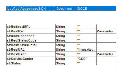

What is the variable need to be create for JSON document.

You should not have the TEXT[variable] in the document variable as you have it in this screenshot.
That should be used in the Create JSON document step to populate it with the response value you get from the REST call.

I have created the response string . Screen shot below.
Getting the Response  is  U "{\"result\"[]}". Screen Shot below
Below variable created for JSON.
JSON properties screen shot below Do we need to create separate string for Source document. Which one I need to use it
