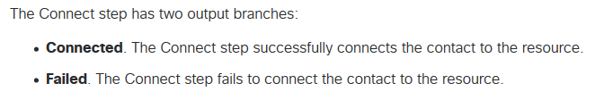

By definition the Select Resource step and Connect Steps, states:
https://developer.cisco.com/docs/contact-center-express/#!select-resource-step/select-resource-step
https://developer.cisco.com/docs/contact-center-express/#!connect-step/connect-step
In your original original script I noticed:
In the above Select Resource step you have the "Connect" parameter set to "Yes" and by definition, it is my understanding in this scenario, you do not need to use a "Connect Step" the output branch for this is, the agent is connected.
When using the "Connect - No" parameter in the Select Resource step, this allows you to place additional step items under the "Selected" output branch in sequence prior to adding the "Connect" step, where the resource and call is then connected.  As in the image above, a Set Enterprise step is placed so that Peripheral and Expanded Call Variables can be made available to Finesse from the Enterprise Data Manager (or even other logic can be added).  In these items, I also have learned to make sure that the Timeout setting is at least 1 second less than the Ring No Answer timer on the CUCM Line Setting for the agent device.  You want to make sure that RMCM maintains control of the call in a Return on No Answer (RONA) scenario.  I noticed you had yours set at 20 seconds.  That equates to nearly 5 ring cycles(correct?).  You want to make sure your agent lines are above this...if so; because if the line times-out for RNA on the telephone line on the CUCM side before the timeout period in your UCCX script parameter, strange things can happen in the land of JTAPI and CTI call control for the contact...
Which leads to the final explanation to your question: "Why 'Goto' Select Resource instead of Queue?"  ...because you want the system to make sure it retains control of the contact (caller in this case).  In the case of a "Failed" output branch on the "Connect" step--you want the system to first check and re-select a new agent resource; and then if one is not available, you want the system to place the contact back in the queue.  Remember, queuing happens when an agent is not available.  Essentially, we can't just place a caller in queue without first attempting to select and find an available resource.  If no resource available--queue the caller.  So that logic is what I was concerned about in your original step(s).
