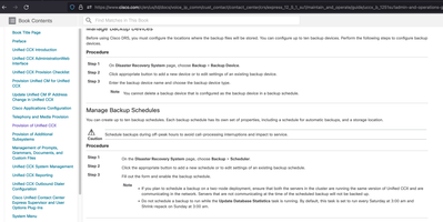

Below the documentation about the Update Statistics  process
https://www.cisco.com/c/en/us/td/docs/voice_ip_comm/cust_contact/contact_center/crs/express_12_5_1_su1/maintain_and_operate/guide/uccx_b_1251su1admin-and-operations-guide/uccx_b_12_5_2admin-and-operations-guide_chapter_011011.html
