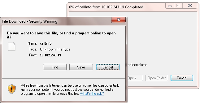

Hi Gergely,
Yes when I try to call URL on IE using 9080 it ask me do download file. Please see below
Try setting "Content-Type" to "text/html" in the Set HTTP Contact Info step.
G.
Hi Gergelly,
Its working fine with IE after making your recommended changes :) What is our next move?
