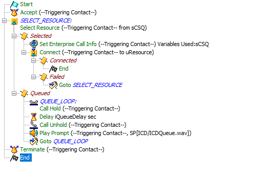

In the CCX step reference guide there is a warning which states "Never insert a Goto step in the middle of a Select Resource step flow. (Doing so can cause an active agent to enter a Reserved state that can only be exited by logging out of the system.)"
I am getting some agent stuck in reserved issues with a script that I have written and I am wondering whether I have fallen foul of this issue.
In my script the Select Resource step has Connect set to No
The script then has a Set step that does some calculations to work out how how the caller queued for followed by a Set Enterprise Call Info step which passes the queuing time and some other stuff through to be presented in Finesse.
I then have a Connect step and under the Failed branch I use a Goto step to send the call back to the queue.
Is this setup ok? - I have also tried dequeuing the call, increasing the priority then using a Goto to queue it but see the same issues.
What is the best practice for the Connect > Failed branch?

"...The Failed branch should GOTO (or go back to) the SELECT Resource step so the system processes can select another resource..."
Actually, that's not accurate. The Failed branch of the Connect step does not execute any steps at all, provided, there is at least one more ready resource who can be reserved. In which case, the Select Resource step becomes the active step in the script, and your Failed branch steps never execute. I'll see if I can put up evidence online about this, because it's come up a few times now, and I'd rather just show people, than keep explaining it. Here is a video showing it in action: https://youtu.be/kwEVBkka_Mo
In the meantime here's a screenshot of a sample script:
And the logs showing that the first Agent where we failed to connect to them, both:
  1. Never executed the step inside of the Failed branch
  2. Didn't need a Goto step to help it back to the Select Resource step (the interruption handler did that for us).
Then the logs show that the second Agent we failed to connect to, which also happened to be the last Agent available in that moment, did execute the step inside the failed branch.  In which case, what you really want in that step is to go into the queue loop you've created for yourself, and not back to the Select Resource step.

Unfortunately, YES you are creating your problem.  The Failed branch should GOTO (or go back to) the SELECT Resource step so the system processes can select another resource--and if another resource is NOT AVAILABLE, then the system can process the contact by sending it to the QUEUING branch:

...as I said in my earlier post, sample scripts in the Cisco repository demonstrate this method--consistently, on multiple scripts. Perhaps this is a best practice?  Maybe.  Maybe not.  I didn't publish any of the scripts in the repository.  I borrow from them liberally, though.  ;-)
They do not ever demonstrate using a "Go To" step to a label in the event of a "Connect" step "failed" branch outcome.
I do not think a new "Resource Select" process will happen correctly if this is done.  Just because the script allows the path of the contact to "jump to/go to" a different place in the flow--I don't think it will properly register with the resource selecting mechanisms in the program that cause it to drop down into the queue branch or selected branches by design.  The goal is to get the contact connected to a resource; queued if none are available.  Does this make any sense?  Putting a "Go To" step in the failed branch of the "Connect" step and dropping it in the "Queue" branch of the "Select Resource" step, to me, is illogical.
I haven't done this, but I may try it in my lab just to see what happens -- <reserved>...

Actually you were pretty blunt, telling the OP they were doing it wrong and causing their own problem, and that's false.

Basically, you just don't want to use the Select Resource step, and then never ever use the Connect step. The Agent selected will be stuck in the reserve state. It's that simple. Of course you can use a Goto step in there, just as long as, at some point, you then also use the Connect step to actually ring the Agent's phone.
How you have it now, with the Goto in the failed branch, going to the Queuing area, is just fine.

I did some more troubleshooting and traced the issue that caused me to post this question to the fact that transferred calls to the application trigger number were be routed through a Translation Pattern rather than hitting the trigger directly - rookie mistake!
