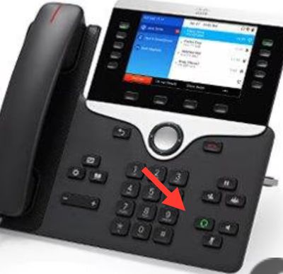

Cisco 8861
This button is what @Nithin Eluvathingal refered to.

matee
I press this button but nothing change, the button not light-up, only the line open like I will make a call
That is expected, youā€™ll need to press the headset button and then end the call attempt by pressing the soft key button. This should get the button to stay lit.

As @Roger Kallberg suggested, you need to activate the headset by pressing the headset button. To terminate the call attempted, use the soft key button.

matee
When I press headset button it shows to me on screen New Call and then I press End call button also I tried with softkey cancel but no light-up on handset
