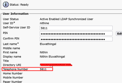

When you configure an end user or when you sync users from AD, What ever value on the telephone field will be seen as extensions when searching  from phone corporate directory. If you see different extensions when searching a users from phone corporate directory, check the below field on CUCM  enduser page.

The extensions are the same in CUCM.
The screenshot i shared is end-user page configurations and not the extension configuration.
