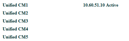

The below mentioned screenshot is from my  phone network webpage. Phone network settings will display the DHCP server IP.  You can use this information  to identifying the DHCP server if you don't know the server .
If you add both pub and sub on CM group, you gone see both servers on Unified CM information.

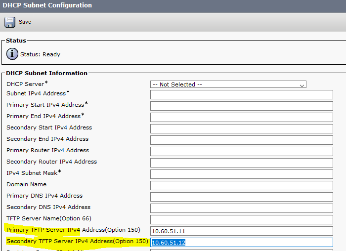

if DHCP is on CUCM, go to DHCP Subnet Configuration page and check if both servers are mentioned on the TFTP.
