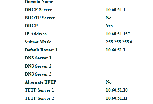

For phones to show both tftp address Check the dhcp server option 150. If both act as tftp add both IP as option 150.
Dhcp can be running on your CUCM server or a router or it can be on any windows server inside your network.
check on phone networking settings,it will show the dhcp server details. Check which server is acting as dhcp for phones and check the dhcp configuration.

The below mentioned screenshot is from my  phone network webpage. Phone network settings will display the DHCP server IP.  You can use this information  to identifying the DHCP server if you don't know the server .
