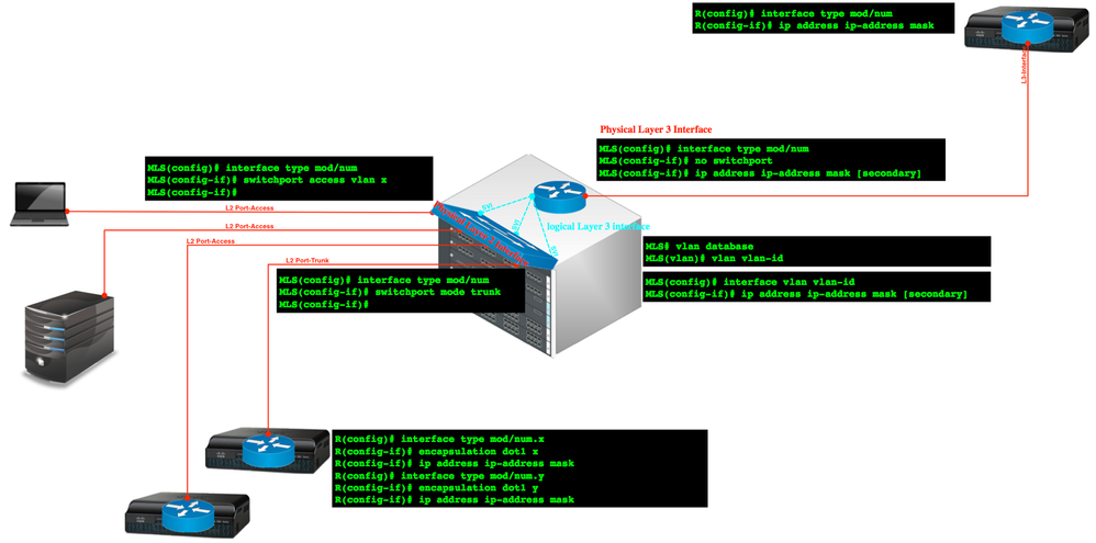

before remove VLAN IP
SW-CE/R
all client in SW will use VLAN IP for routing packet and use it to forward the pocket to CE/R
after remove VLAN IP
all client now need L3 device to routing packet and here the router must do routing packet for these client.
here you do one mistake
config interface between two SW and CE/R is L3 with
add no switch port
command.
so
finally
SW have many VLAN and you want SW to DO inter-VLAN and advertise the VLAN SVI IP to CE do
run
ip routing
config SVI IP for each VLAN
interface between SW-CE/R
no switch port
ip add <subnet /30 different than any SVI IP>
OSPF
net SVI IP
net subent /30 of interface connect SW-CE/R
SW have many VLAN and you want R/CE to inter-VLAN
run
no ip routing
NOT config SVI IP for each VLAN
mode trunk
allow all VLAN you need
NO NEED OSPF
in CE/R
run
subinterface for each VLAN in SW
if you assigned IP to L3 port (port 48) your other end device in same network should connected to port 48. not to 37. as per my understanding. also if you can share some basic diagram with port numbers, that will give us hint.
Good luck
KB
