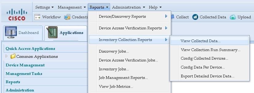

If you would like to export the collected data for an offline upload please use the following instructions.
  1. From the CSPC GUI, go to Reports -> Inventory Collection Reports -> View Collected Data…manual_export1.jpg
