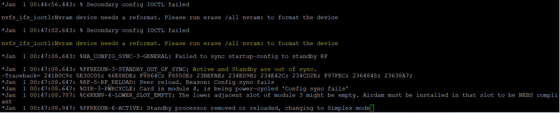

can anyone please help to get this issue fixed, I have C6807-XL Modular Switch, and trying to make them single unit however, SW-B is working fine, and SW-A is not working properly, when I finish the VSS configurations on SW-A it required reload. after reload switch went into rommon mode and I have to putt the  'Rommon 1> boot'  manually to make the both line cards up. Line card 3 works automatically sometime, but line card 4 will always required boot command.
when the line card finishes the boot process it came up with normal router, and when we reload the switch again it requires the manual boot command to get up and work normal, after this switch is out of the configurations that I configured very recently.
*Jan 1 02:58:03.591: % Secondary config IOCTL failed
Warning: The nvram is either corrupted or uninitialized. Initialize the nvram by executing the command 'erase /all nvram:' after bootup.
anyone please help will be thankful for the sincere advice.
This is a VSS capable switch.
VSL ports can be configured in slot: 3
*Jan 1 00:30:58.739: %SYS-3-LOGGER_FLUSHING: System pausing to ensure console debugging output.
*Mar 1 00:00:02.543: %PRST_IFS-3-GENERAL: persistent media IFS general error: Open Read - can't open nvram:persistent-data errno is 11
*Jan 1 00:30:15.999: %VS_PARSE-3-MISMATCH: Unable to open STARTUP-CONFIG
*Jan 1 00:30:15.999: %KEYSTORE-3-IFS_OPEN_R: Failed to open file "nvram:/private-KS1" for reading software keystore. (Resource temporarily unavailable)
Firmware compiled 02-Sep-19 08:39 by binugopa Build [26112]
*Jan 1 00:30:58.739: %PFREDUN-6-STANDBY: Initializing as STANDBY processor for this switch
*Jan 1 00:30:59.471: %SYS-3-LOGGER_FLUSHED: System was paused for 00:00:00 to ensure console debugging output.
*Jan 1 00:31:01.355: STBY: Force standby supervisor as a DFC-only
*Jan 1 00:31:01.611: %PFREDUN-STBY-6-STANDBY: Initializing for SSO mode in Default Domain
If the CLI command 'erase /all nvram:' has not been run or did not complete successfully, please run 'erase /all nvram:' to re-format the device.
nvfs_ifs_ioctl:Nvram device needs a reformat. Please run erase /all nvram: to format the device

@Muhammadnawaz wrote:
Are you sure to proceed?[confirm]
Did you enter "Y"?
yes I proceed with Yes
Contact Cisco TAC or RMA the supervisor card.  I do not know what is wrong with it.
