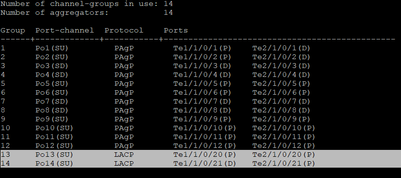

I have one problem with Port Channel, the network topology is as follow :
-- two Core switch C9407R connected with VSS
-- two FPR 1150 as (Active-Standby) with port no. 8
-- Creating port-channel ID:13 between the core switch and FW 01
              Core switch port 1/1/0/20   connected to FW01 port 9
              Core switch port 2/1/0/20   connected to FW01 port 11
-- Creating port-channel ID:14 between the core switch and FW 02
              Core switch port 1/1/0/21   connected to FW02 port 9
              Core switch port 2/1/0/21   connected to FW02 port 11
The problem is that port 1/1/0/21 in core switch is not come up in state (with no specific reason to me )
however it works fine when connected to other devices
And, I try the port from firewall side , also working fine
any suggestions !!

Reza Sharifi
So, PO 13 works fine but not PO14?
Anything in the logs of the core switch?
Also, what is the output of "sh port-cha summary"?
HTH
Hi Reza
PO 13 is working fine, but PO14 is working also (with one port downstate)
No logs from the core switch
So, if you connect the same physical interface (1/1/0/21) to another device (not in a Portchannel), does it come up?
I am trying to understand if this is a physical (layer-1) issue.

Can you run show spanning tree on 1/1/0/21?
Hi Flavio
Core#sh spanning-tree interface tenGigabitEthernet 1/1/0/21
no spanning tree info available for TenGigabitEthernet1/1/0/21
That´s weird, right? I mean, spanning tree should look at it. If you have a VSS and it is connected to a cluster, you can have potencially a loop.
The problem now, why this port is not coming up !!!
The loop should not exist as both ports in Channel group and the two core switch in one logic domain
