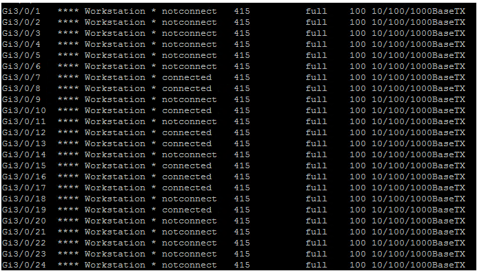

12.PNG Pls find the show interface status report. All the ports admin enabled. POE device got connected to Avaya IP phone.
Can you post full configuration and version we have requested other post.
