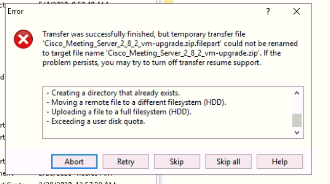

Hi Collin,
I'm using winscp too, and I'm trying to copy a CMS upgrade file to CMS Server (2.8) but Im getting below error.
I tried to disabling resume transfer, but when I disable resume transfer it not allowing me to copy the file.
Regds
