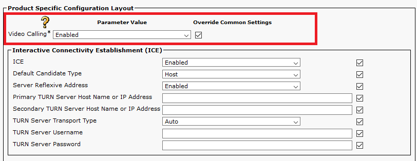

opintainho
I think is easier to remove the video options directly from the phone config in CUCM.
The video capability is enabled by default to Jabber phones.
Phone Configuration -> Product Specific Configuration Layout -> Video Calling = Disabled.Video Capability Jabber Phones.png
No that would not be the best solution. This will remove the capabilities of the endpoints to do video internally. Using audio forced is the most efficient solution here
Please rate all useful posts
