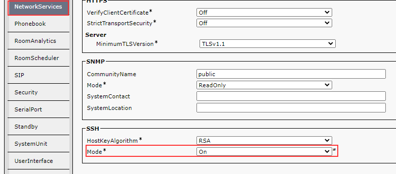

If the system is registered to CUCM, then you might have to enable SSH in the device configuration (Network Services -> SSH) in CUCM:
After you book the meeting, you can issue the xcommand to check the contents.
