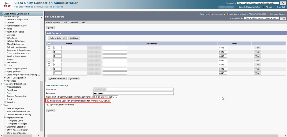

The PIN in Communication Manager is not the same as the PIN in Unity Connection. To change the PIN in CUC you do it from the webUI of CUC at this link,   https://<FQDN of CUC>/cuadmin, then look up the user to change under Users > Users > Find Users where search for Alias, Extension, First Name, Last Name or Display Name. Once you find the user to change select it and go to Change Password and set the Voicemail PIN.
If you want and have a version of CM and CUC that supports it you can get the systems to use the same PIN. To do that you would set this setting.
