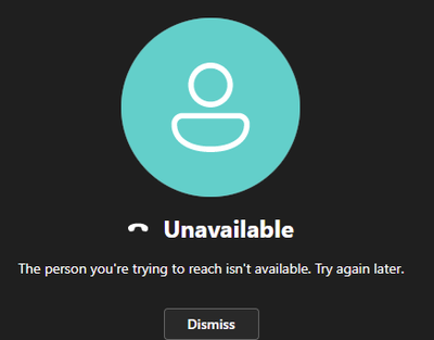

Hi all,
I've got a simple call-flow (MS Teams -> SBC -> SIP trunk -> CUCM) ... calls from CUCM to Teams worked fine but not calls from Teams to CUCM. When a user in Teams dials for example extension 1111 the call rings twice then (see screenshot below). From the logs on the SBC it seems like the SBC is sending 1111@username.domain.com to CUCM and seems like CUCM does not recognize the extension and sends back a message "404 Not Found" to the SBC.

I've tried update the OTLD and Cluster FQDN in Enterprise Parameters but the result is same.
From the logs on the SBC ... I am seeing these messages
SIP/2.0 503 Service Unavailable
V0AA0401 "Unable to find a device handler for the request received on port 5060 from 10.11.121.22" where 10.11.121.22 is the IP of the SBC.
I am not familiar with trace logs in CUCM and I think I need to turn enable trace logs in CUCM to further troubleshoot the issue. Any ideas where I enable logging in CUCM and what trace logs I should be enable ?

Before going into the traces and how to get them. Do you have a SIP trunk in CM with a IP of 10.11.121.22? If not the CM will be ignoring the traffic.

Jonathan, you fixed my issue thanks a lot
