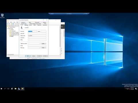

with that said anyone in the same situation that finds this question, I will provide a video on how the sync system is set up that I found on youtube, just so you know the simple process.
'https://www.youtube.com/watch?v=hiuMoa-sYW8'
What I ended up doing was going to the LDAP Directory in CUCM and under LDAP Manager Distinguished Name I noticed the format. it was CN=CUCM,OU=IT,DC=example,DC=local. out of curiosity, I changed it to 'CUCM@example.local',  saved it, and performed full sync. This resolved the issue.
