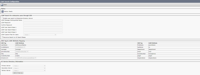

What is your LDAP search base? Are the users possibly being created in a different location in the LDAP tree? Also, has the password expired on the account you are using to do the LDAP sync? The only special permissions the LDAP sync account requires are "read all properties of user objects" and (optionally) "password never expires".
I attached what I think is the LDAP search base. They are being created in the only and same LDAP tree. The password to the account is set to never expire.
The LDAP search base in your screen shot is empty.
Thank you, I was able to figure out the issue and posted it as a reply and solution in the page.
AFAIK, the configuration page is for "Directory Server User Search for Cisco Mobile and Remote Access Clients and Endpoints". To sync user from AD to CUCM, configuration is on "LDAP Directory"
