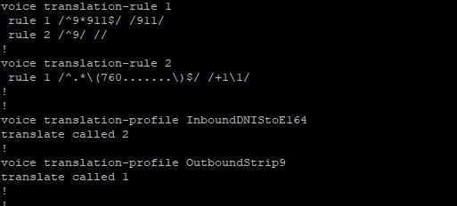

Here is the info I believe you are referring toCube voice brief.JPGcube voice translation.JPGCube dial peers.JPG
First call in gateway output is going via dial peer 21, which has destination pattern as 9T.
Can you please let me know the dial pattern used by your users, is it 9+916859xxxx or 91+916859xxxx  ?
