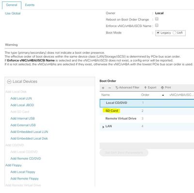

The Boot Order looks like this:
After assigning the service profile with those settings and booting the server, the UCSM shows a different "Configured Boot Order" and "Actual Boot Order":
Also if I look into the boot menu (press F6 during the boot process) the SD card is not shown. The Bios tells me that the SD card as boot option is disabled.
But I can do a Boot Override in the Bios to start from SD card.
I tried several things e.g. re-acknowledgement or factory reset to change this behaviour but without success. Does anyone witnessed the same problem?

In your configured boot options, I don't see the local device, SD card that should be there.
In your localdisk policy, please confirm you have the flexflash enabled.
Config vs actual can frequently be different if the configured devices aren't actually active/available (i.e. remote virtual media doesn't actually have any NFS or CIFs ISO mounts defined)

I believe Kirk was also referencing your configured boot order from the first screen cap you sent.  The SD card is not listed as a boot option.
The disk config policy looks fine, it would seem that the underlying disks are at least configured at this point.  As mentioned, the boot order that you initially sent does not contain the SD card boot option.
