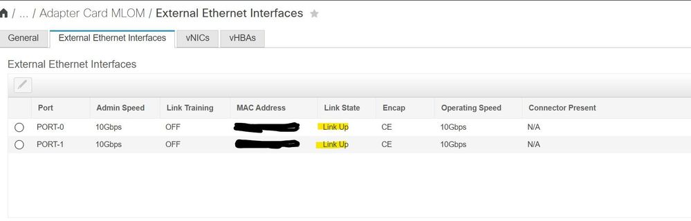

Kirk J
It depends on what 'network card' you are referring to.
If you have a MLOM/VIC card then  you can see the link state:
If you have an add in card like a 4 port Intel 1Gb port card, then those don't provide any out of band management to report that information over to the CIMC GUI.
You would need to run commands inside the booted OS on the overall server like ethtool or similar that would show the connected status, transceiver info, etc.
