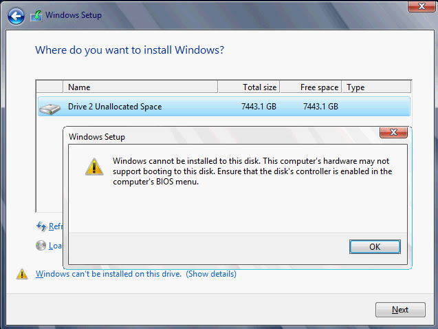

Windows 2008 installation error on CISCO C220 M4
i have any problem with a C220 M4 Server.
I configured the CISCO 12 G SAS MODULAR RAID CONTROLER with one virtual drive in RAID 5 (boot true).
Images intégrées 2
After in the bios i enabled [HBA] on the OPROM module
Images intégrées 3
Images intégrées 4
But when i launch the installation of WINDOWS 2008 SRV i've :
I verified on the LSI MEGARAID SETUP and of course i selected "CONTROLLER BIOS" on ENABLE.... but after 1 billion of reboot i cry on my keyboard.
Images intégrées 5
Please you have solution ?

It appears you are trying to install Windows 2008 to a 7.4TB boot volume.
This requires using GPT volume and UEFI, which I think 2008 supports.
You will need to make sure your boot options have UEFI enabled.

Hi Kirk,
All is UEFI (see the screenshot)
But no change.

Hi there,
small question. is that installation media ready for GPT partitions?
Regards

Hi Kasun
Yes is ready GPT.
I just want to install it on a 100GB partition
