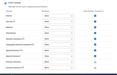

the other place to check  is under the User go to Calling --> Outgoing Call Permissions. and make sure that user can dial internal calls.

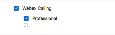

hi @kgroves42
Thank you for your suggestions. The licenses seems to be ok, please see the screenshot at user settings level:
As for Outgoing Call Permissions - we tried both default settings and Custom settings where all is enabled. Unfortunately we can't still make it work. Our custom settings are almost same as yours (we allowed International calls as well):
