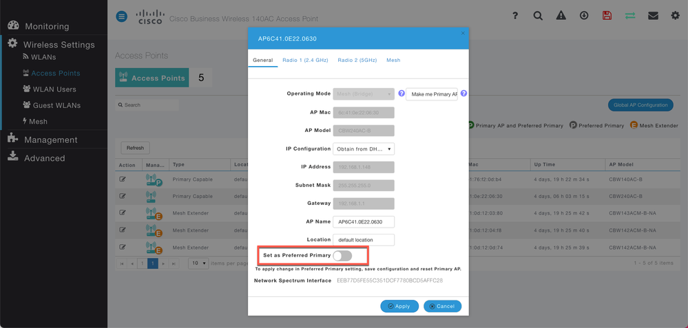

Thanks for the additional detail. Here are the steps to set a preferred primary access point:
1. (After logging into the web gui) Wireless Settings > Access Points
2. Click the edit icon to the left of the AP you wish to set as the preferred primary
3. Click the Set as preferred primary toggle and click apply.2021-08-06_15-04-20.png
The red, amber, green pattern points to an IP config error, which makes it curious that you were still able to access .102. Let me know if you continue to run into issues.

Thank you! Telepathy is working well. I did that yesterday afternoon (was not sure, but rolled the dice) before seeing this and was successful in getting everything back inline. I just need to factory reset the original master and re-acquire as it never came back online. (Did show as a pending AP, but never could get it adopted)
