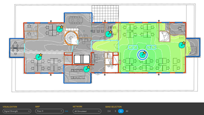

See a comparison from Ekahau between 6-GHz and 5-GHz, cell size is more or less the same, so try tresting with different client adapters (Intel AX211 (https://fccid.io/PD9AX211D2L), Qualcomm WCN985x for Windows laptops (https://fccid.io/J9C-QCNFA765), or Apple silicon from iPhone15 Pro (https://fccid.io/BCG-E8437A)). As you can see the Intel chipset is the only one with reduced power (up to 21 mWatt) in comparison with Qualcomm (up to 156 mWatt) or iPhone 15 (up to 75 mWatt).
Thanks for that info.  I will see if I can get my hands on a different Wireless NIC to test with.
@JPavonM, thank you for sharing those Ekahau screenshots. What dBm was each radio set to at that time?
JPavonM
That screenshot is from a design using Mist APs with 8dBm.
The added "problem" with modern APs is that vendors tend to change the radiation pattern from previous generations to focus the signal more in the downward direction (hemispherical pattern) than to the sides (toroidal pattern), thus reducing the coverage cell.
