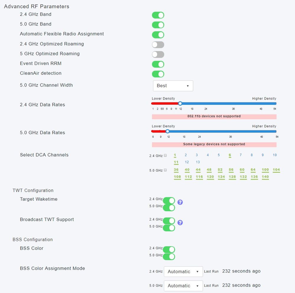

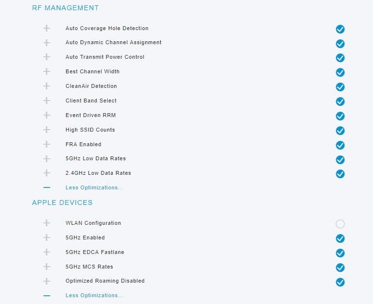

I can't figure out if this was a release issue update with 8.10.121.0 but I've tried to rollback to 8.10.112.0 and it didn't change or if I activated one optimization witout knowing which one did trigger that. Here are my setting in best practices view and in advanced RF ones (I've tried to reach a maximum of them, but this might not be the best) :
Can anybody help me figuring this out ? I've already tried some combinations but I wasn't successful.

In order to achieve higher throughput, you need to set your DCA to 40Mhz at least. I wouldn’t go higher than that unless you know you have more than enough channels with the density of AP’s you have. Also, the client max throughput is dependent on the nic specification, just because you increase the availability on the wireless, doesn’t mean a client that can support what you set will achieve that rate.

Thanks for the reply but I've tried that "already". I've tried to change the DCA channel width value to 40 Mhz (or above) but when I click on apply, it gives me the following error :
And as a consequence after applying, it reverts the change to "Best" and switch off both bands ! :-)
Don't know if it is a "feature" or if it is expected. I'm open to any suggestion :-)
Maybe you have to disable best. Search the guide on that one since you are running Mobility Express.

Hi again,
So here are my new findings :
- I figured out in the doc that radio has to be disabled if you want to change the channel width in RF optimization. That is probably the reason why it shut them off.
- Despite having radio cut, it is impossible to change the channel in the GUI. I had to go by the command line to do so (same error as above, probably a bug)
- I've configured the channel width to 80Mhz to try it out, it didn't change anything on APs.
In order to be able to get a better result, I tried to go to each AP and select the channel manually:
And accordingly, I could get back my max speed:
Now the question : is this behavior supposed to be so ? IMHO it is not expected : if you want to have a central management, "Best" should take the maximum width of each AP model and manage channels according to the surroundings no ?
There is no point of configuring manually each AP ? OK, I've 4 it is not a huge issue in my infra, but the day my neighboor activate some, I'd like my ME controller to react and change them automatically.
What do you think (and the others of course) ? ;-)
There are two options, you set the DCA to 20/40/80 but you need to disable the network first to apply the change, or you manually configure the channel/power/etc. The latter is only used in special cases but rrm is preferred to automatically make the correct choice. 80mhz might not be a good idea in a high density deployment also.
-Scott
The "best" menu selection means that the APs check how much your channels are used and will then, based on that (plus Country selection) select an optimal channel width per AP radio interface. I'm not sure how often this runs on Mobility Express by default, but probably every 1 hour or so (check the DCA options). For companies, it's often recommended to use 20 or 40 MHz channels, to have less overlap which in the end offers higher performance in a busy network.
The error shouldn't pop up though, which version are you using?
