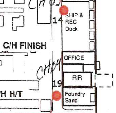

I'll start by saying that I realize that the determination for which AP a client connects to is solely decided by the client's network adapter. But I'm hoping someone can assist me in making changes to the APs to persuade the client devices in this office to connect to the appropriate AP.
We have a Cisco 2504 WLC with 20 AIR-CAP2702I-A-K9 access points and 24 AIR-CAP1532I-B-K9 access points at our site. The 2702 APs are primarily in our office environment where as the 1532 APs are primarily in our manufacturing environment.
We have a small office labeled 'office' below that houses 3 associates. The two red dots below are the nearest APs. They are both AIR-CAP1532I-B-K9 APs in the manufacturing environment.
I've monitored and witnessed the associates' devices in the 'office' room bouncing between the two access points above Both APs are about equal distance away and have similar signal strength. When using a Wifi Analyzer in their office I observed that both APs were about -75db.
I provisioned a spare AIR-CAP2702I-A-K9 AP and mounted it to the dropped ceiling in their office. Now, one or two of their devices may occasionally connect to this new AP in their office, but not for very long. The devices are still bouncing between the two 1532 APs much further away with worse signal.

Rich R
Do as the others have mentioned already (update drivers, fiddle with roaming aggressiveness).
From WLC point of view - you don't mention software version but if not already done then update to 8.5.182.7 (subject to which APs you're using - refer compatibility matrix below).
Depending on coverage impact (survey required) you might want to reduce power on those 2 APs now that you have the AP in the office.
Possible workaround: create a different AP group with a different SSID for the office AP and have those users join the "office SSID" and make sure it highest on their list of known SSID.  Since that SSID is only available from the office AP they will always be on the office AP while in the office.  They can still use the regular SSID when away from the office.

Leo Laohoo
The wireless clients themselves make the final decision which AP to join.
When WiFi started taking off 10 years ago, all of the wireless NIC had problems with "roaming" -- The wireless NIC were NOT roaming.  It took a while until the wireless NIC manufacturers released updated firmware which enabled the wireless NICs to roam properly.
Until now, we are still getting threads about brand-new laptops, with obsolete wireless NIC drivers, unable to properly roam.  And my response would be to update the wireless NIC drivers.
Thank you for responding. Unfortunately Updating the wireless NIC drivers was the first thing I tried after researching the forums.

Hi
The client determine which AP it ultimately associates to. You can encourage the client to associate with the strongest signal by modifying " roaming aggressiveness" to medium or high on the wireless NIC properties.

Rich R
Perfect! I like the alternative solution of creating a new SSID and making it priority.
Thank you so much!
You should also take a look at what you have defined for the allowed minimum data rates.  Removing some of the lower rates can help prevent devices from connecting.  However, if your ap's are sparse and you require these lower rates, then that will not work for you.  Other options are to set you min and max power, for example, you can set the office ap to power level 1 which is the highest and devices should join that ap when in the office since the other ap's are at -75.  Sometimes its all about tweaking your environment.

Thank you! That's the kind of tweaks I was looking for when I made this post. I just don't have a lot of experience with wireless to know what I should be tweaking.
