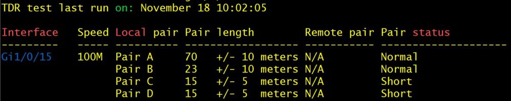

Here are some examples of some "broken" state: (Above)  Pair "A" distance is (significantly) more than Pairs B, C and D.(Above)  Pair "A" distance is (significantly) more than Pairs B, C and D.
(Above)  Pair A & B distance is "0".(Above)  Pair A & B distance is "0".
