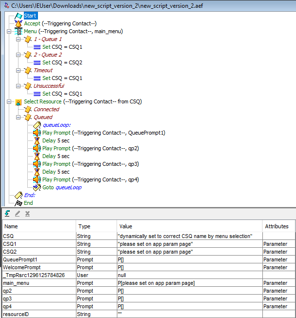

does this looks good to use? also i took this script from somewhere else and edited on it , in the bottom left box with the parameters there is some old parameter like the user one , are those simply parameters ? are they missing something in my script case?Capture2.PNG
Look at the script example above and try to follow that convention more as it's a better experience. The parameters are missing the name of the prompt files you want to play qp2, qp3 queueprompt1 should all have the file name you want to plat during that step.

please can any expert modify the attached script for pressing 1 for a queue and 2 for another queue it would be great help to understand how to integrate key presses and queues for me
We need to know what version of UCCX you have, so we can save it in the correct version format for you.
Or, I suppose I could give screenshots too:
thank you so much , but i want each press to send to a different queue with different voice prompt? like each queue uses a different language so i need each queue to use different 4 wave files , i think here both presses "1" and 2 are using the same queue maybe?  can you please send it to me my ccx is 10.6
No, the solution provided does in fact hold a different CSQ for each of the presses. Look again, and you'll see CSQ1 and CSQ2 being referenced under each press.
In fact, if you simply take that same logic, but apply it to a Prompt variable instead, you'd quickly learn that you already have all of the information to finish this yourself. Good luck.
PS, Your version is too old for me to write a script for. Please consider upgrading to a more recent version. 12.5 is out now.
so in the select resources i would pick eith er csq1 or csq2? and like create another queue loop and choose csq2?
