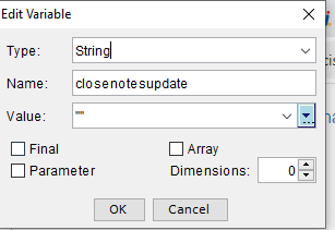

can we use below option to achieve this.
Below string I used to get output whatever output getting . we just play the message.
